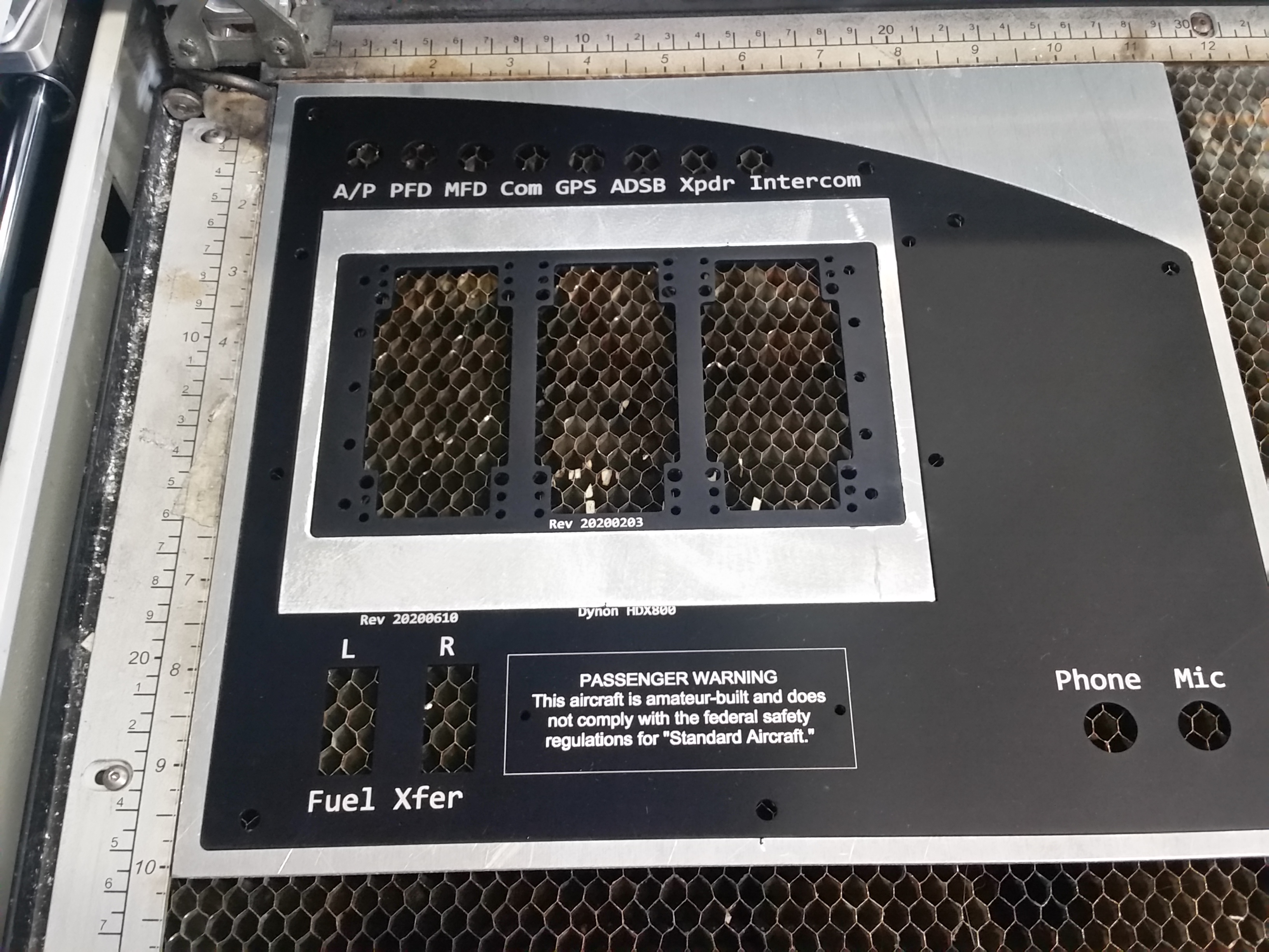

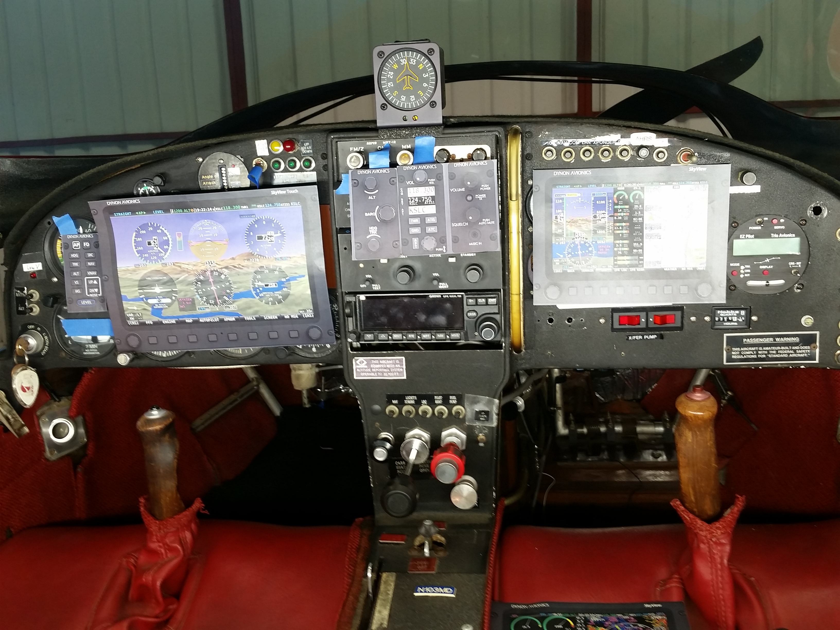

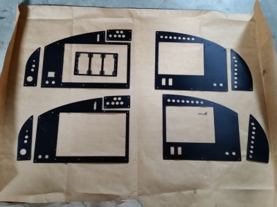

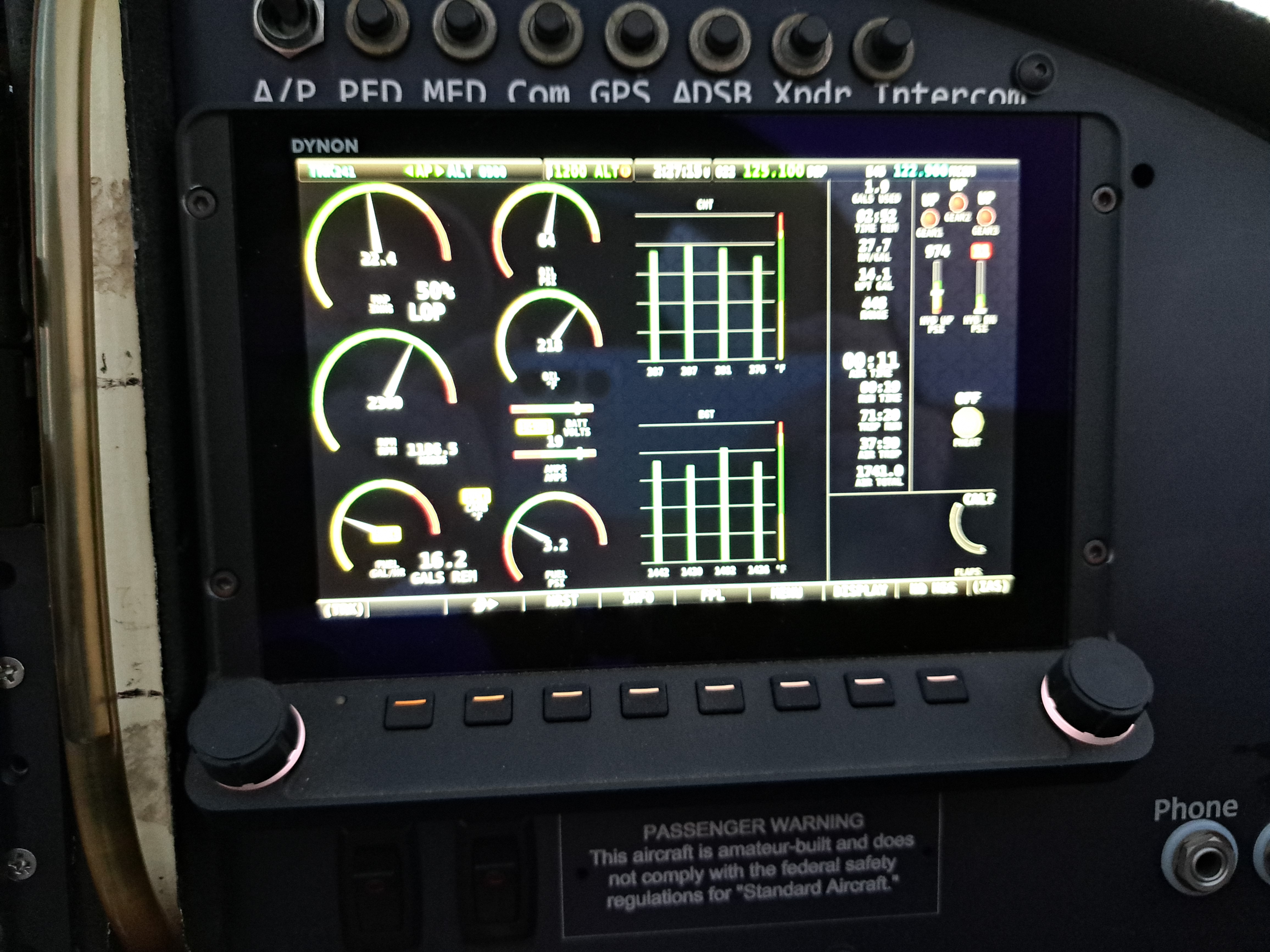

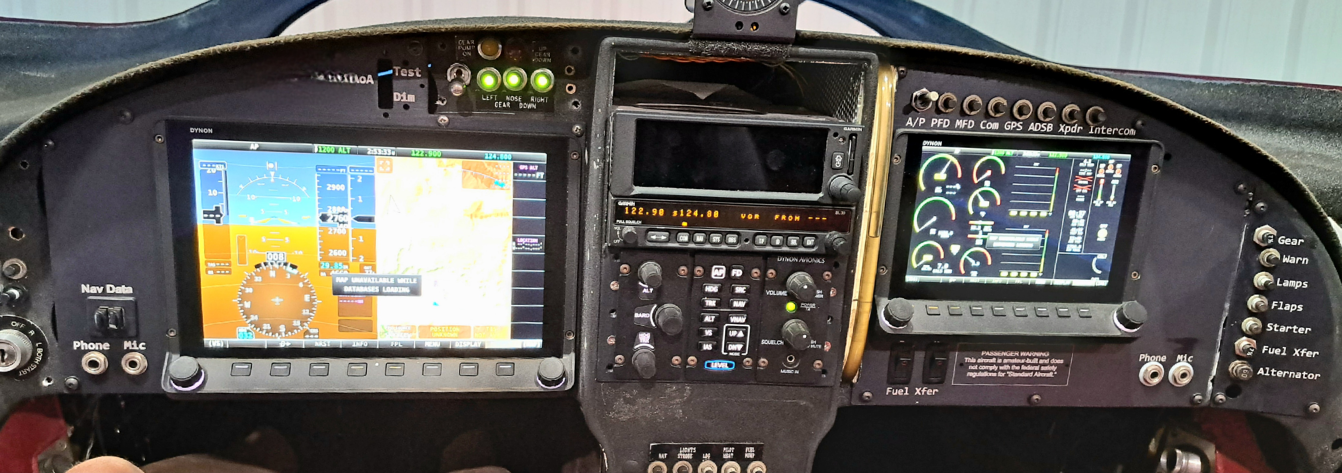

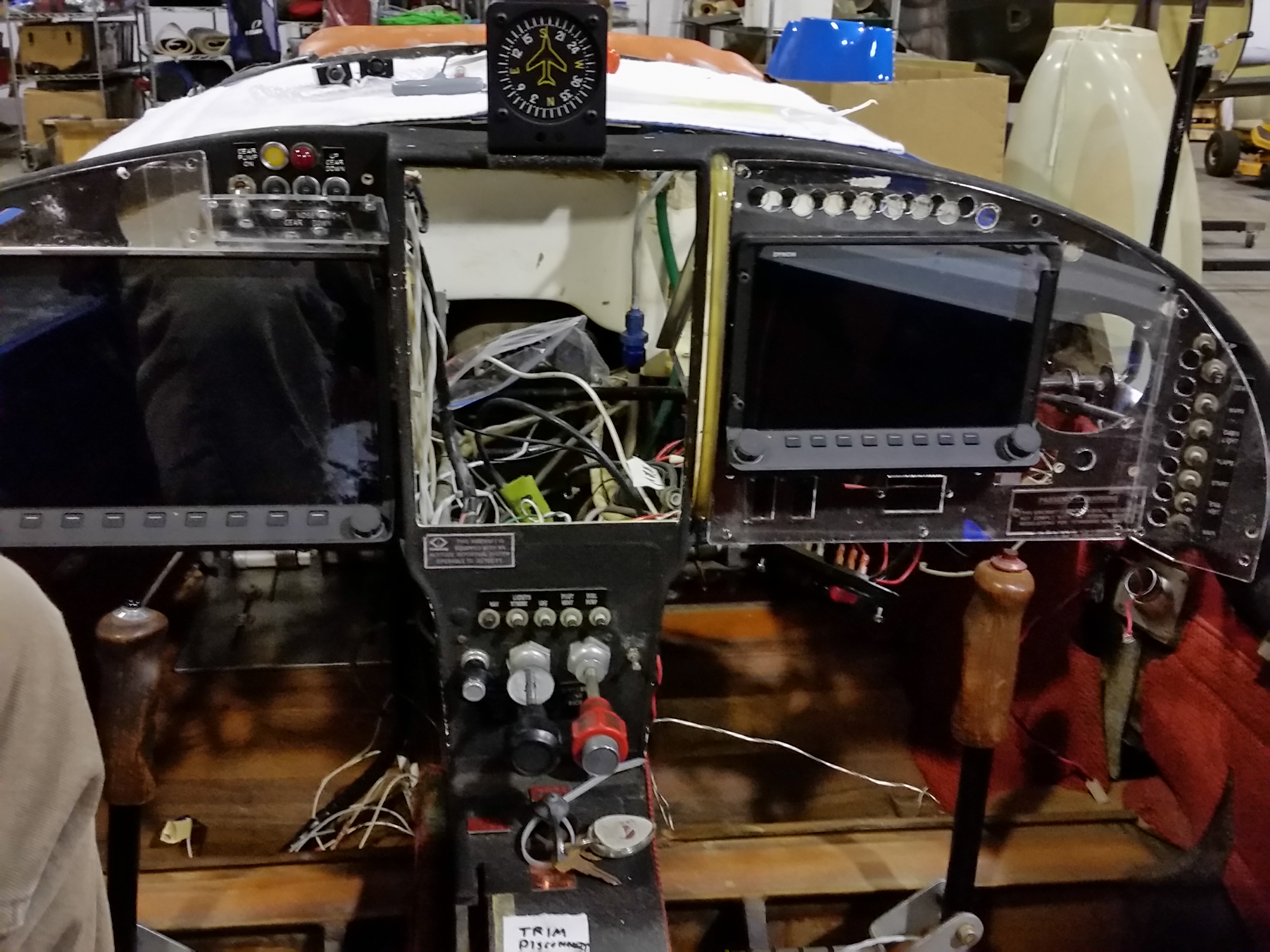

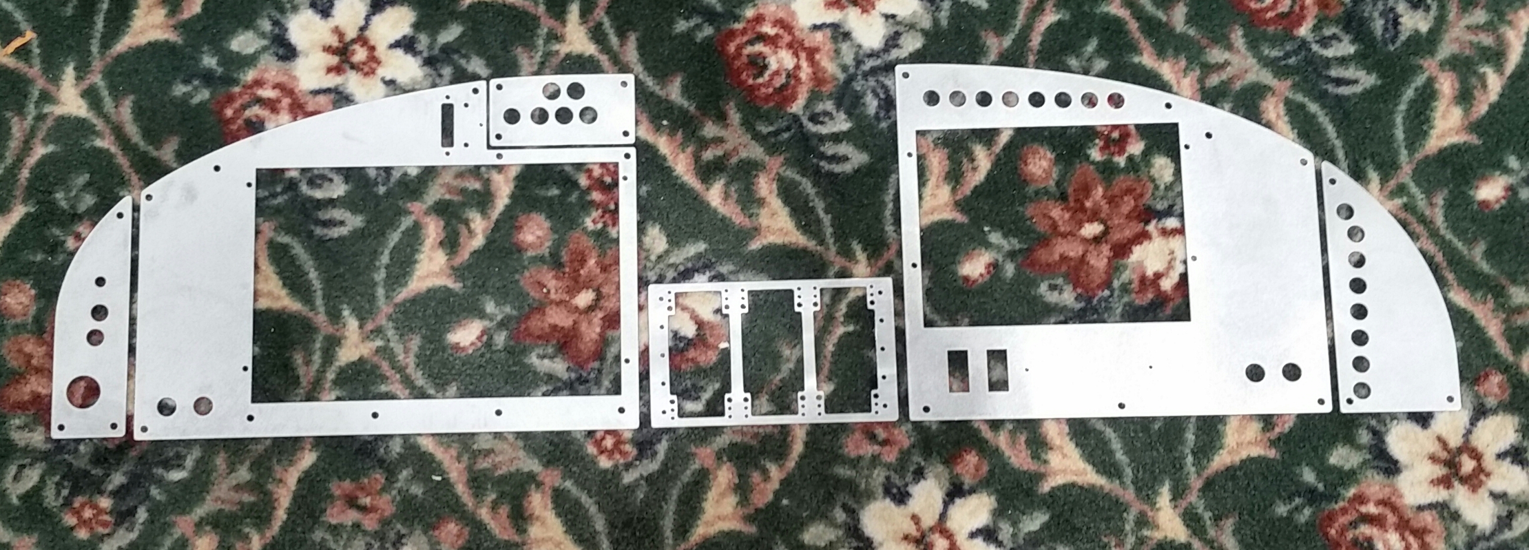

My recent panel build is for a 235. I did all the design in CAD, laser cut aluminum panels, black anodize, then white lettering by CO2 laser.
Planning and thinking about it: Red is cutting, and blue is etching: After cutting acrylic to check the fit and update: After cutting aluminum: After anodize: After anodize and laser lettering:
I used 5mm Consolas font as generated in Rhino3D CAD, chosen for best readability. Almost done: Finished and Flying:
