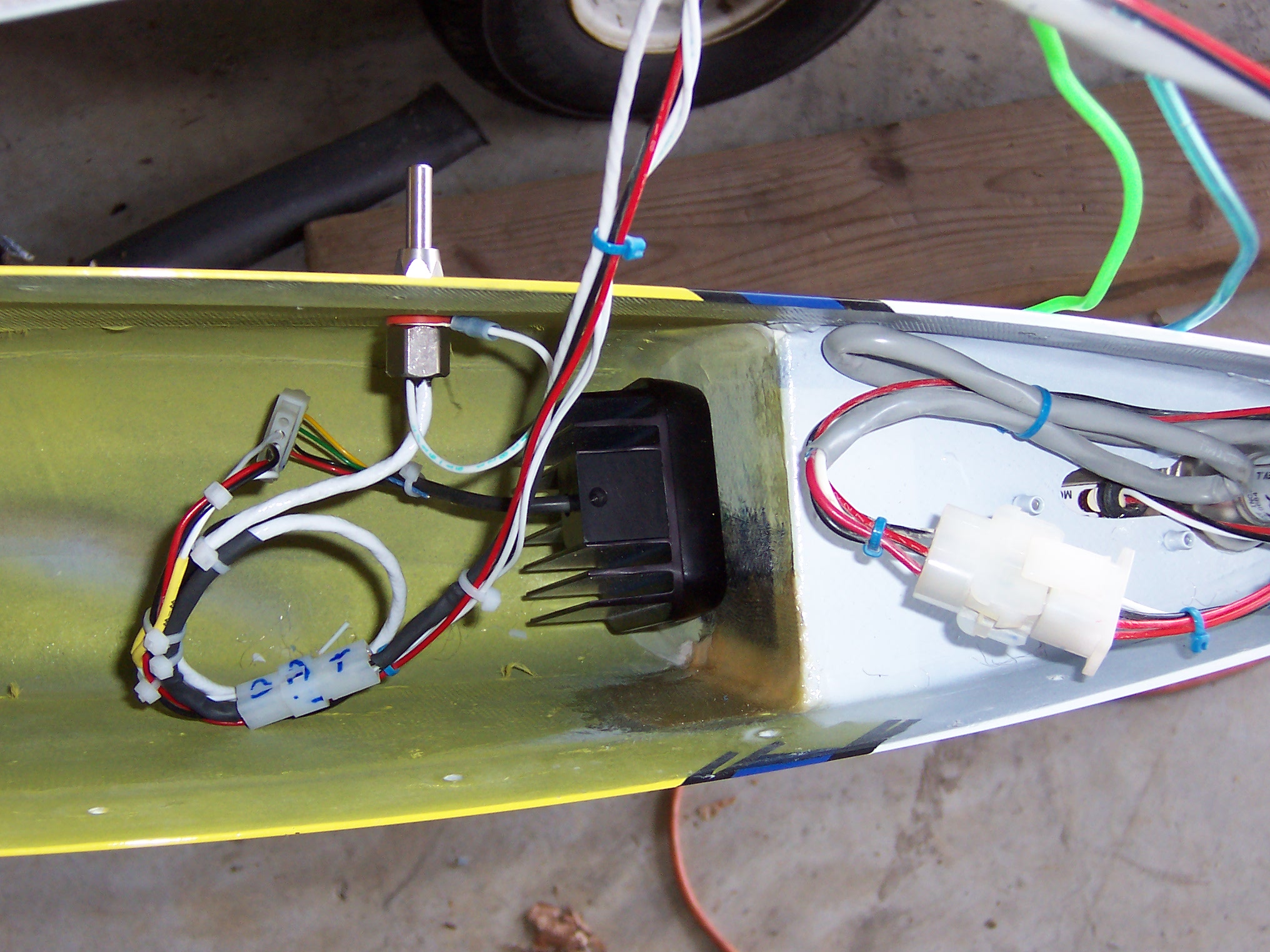

My G3X only needed one OAT probe. I put it under R wing tip. You could do the same on the L side.
Garmin requires shielded cable... that was fun!

Thanks Gordon, do you have a photo, by chance?

Here is a link to my build log. Feel free to nose around.
http://www.mykitlog.com/users/display_l ... 62&row=101
And, I attached a pic of the OAT probe in the right wing tip. Tip is removed and laying upside down in this pic. Well... I tried. File too large! Go to the mykitlog link and look at 6/26/17 entry.
Build on and have fun!

Pic added using the new larger file size process!
Posts: 156
Thanks Gordon. Do you find that location to be fine and out of the way enough to not catch on stuff?
