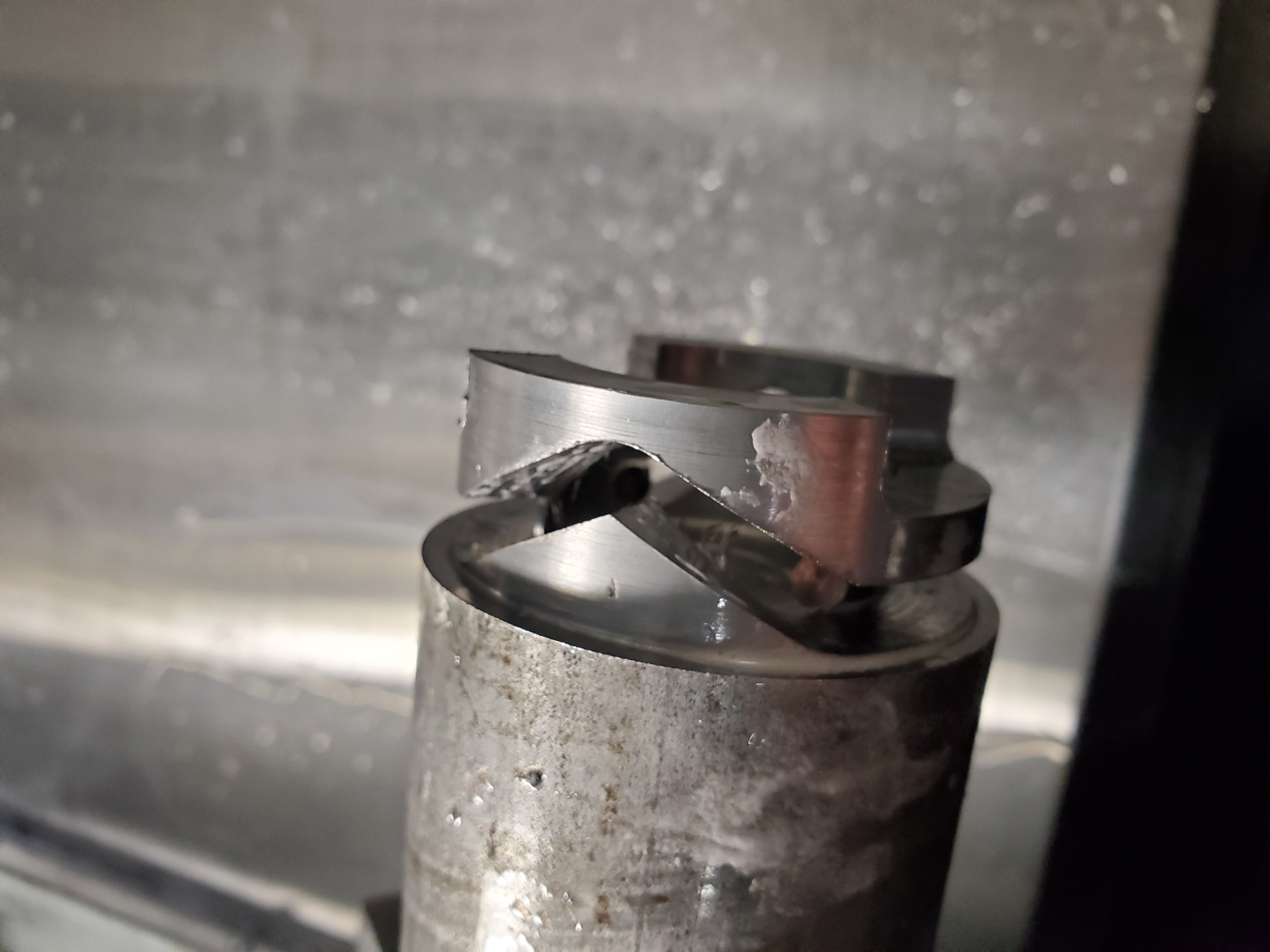

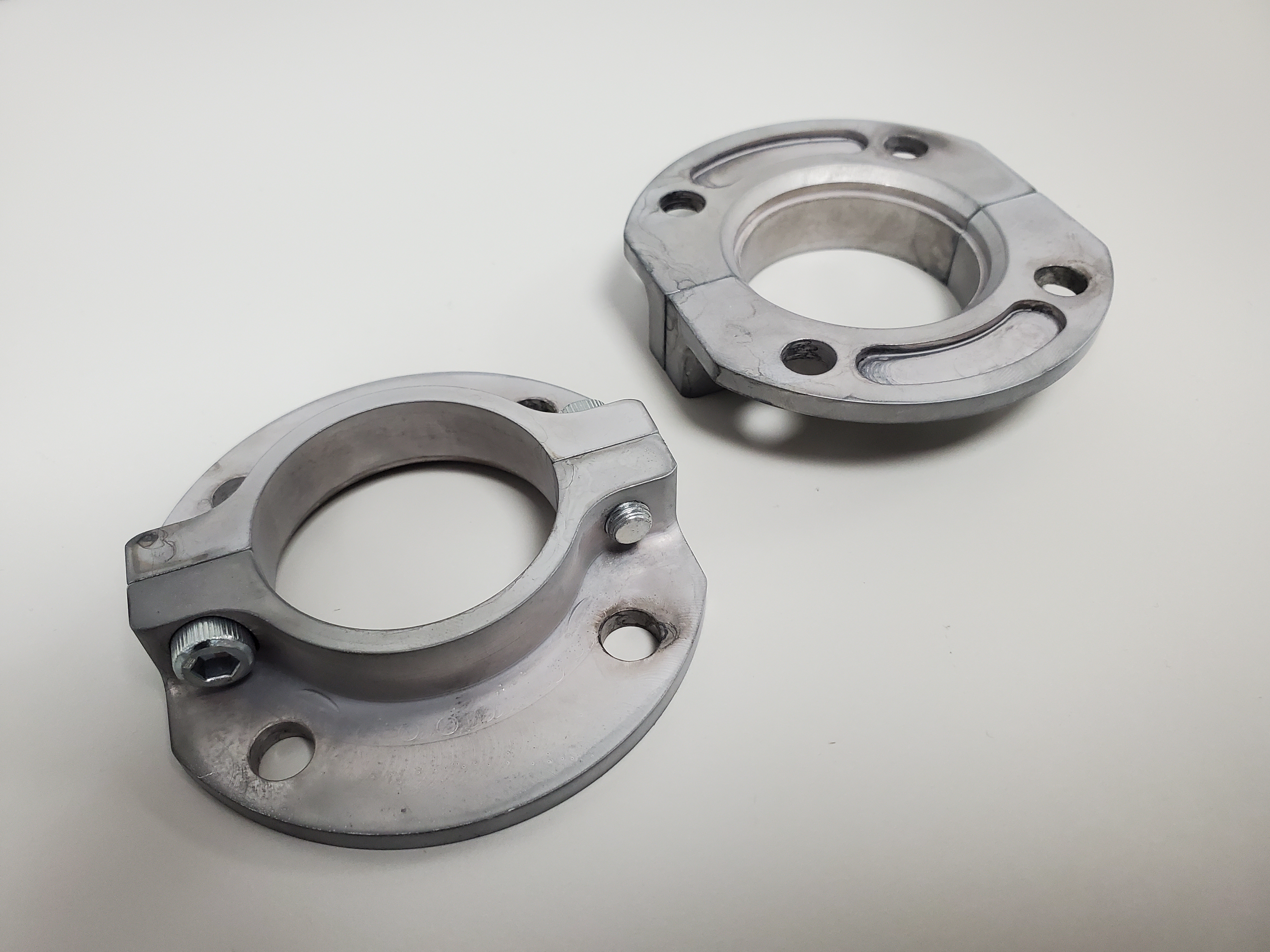

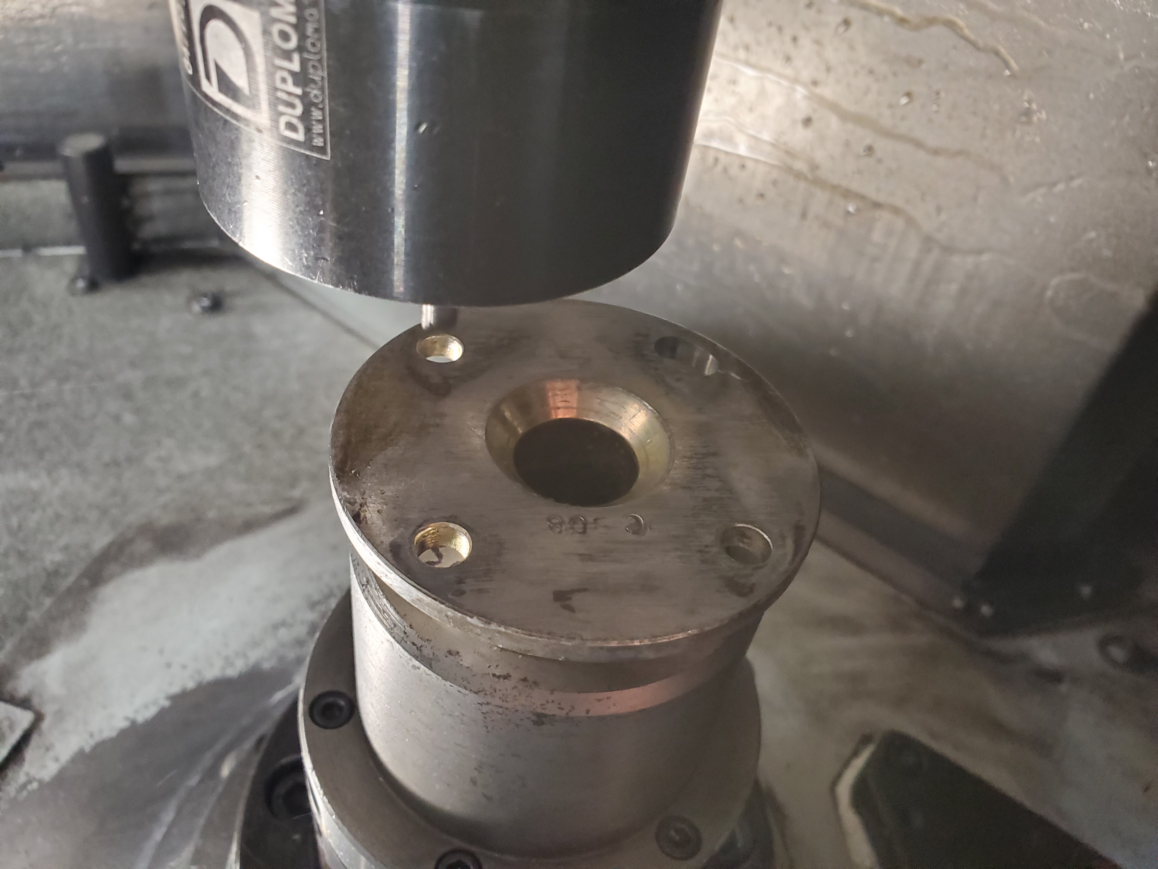

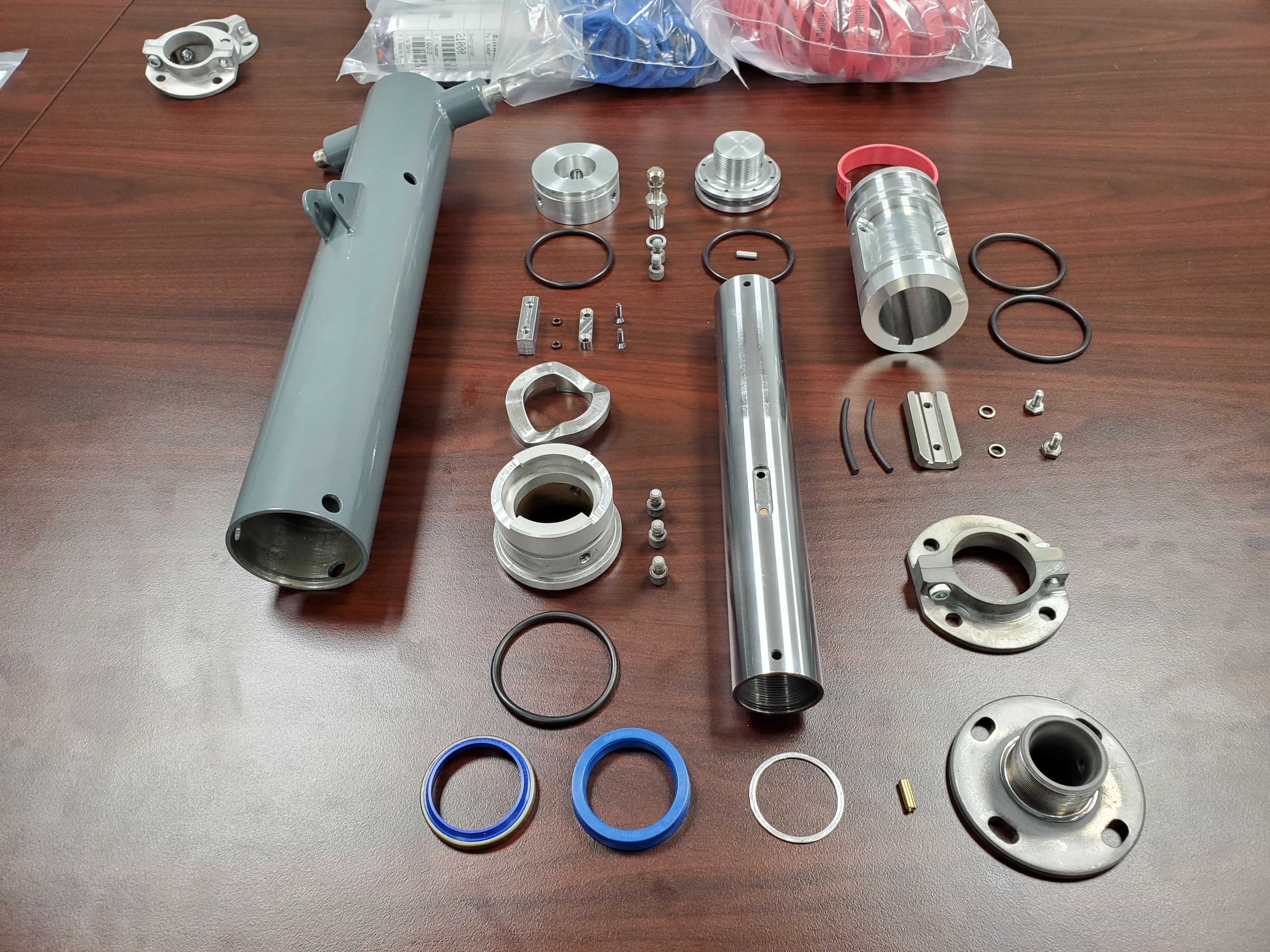

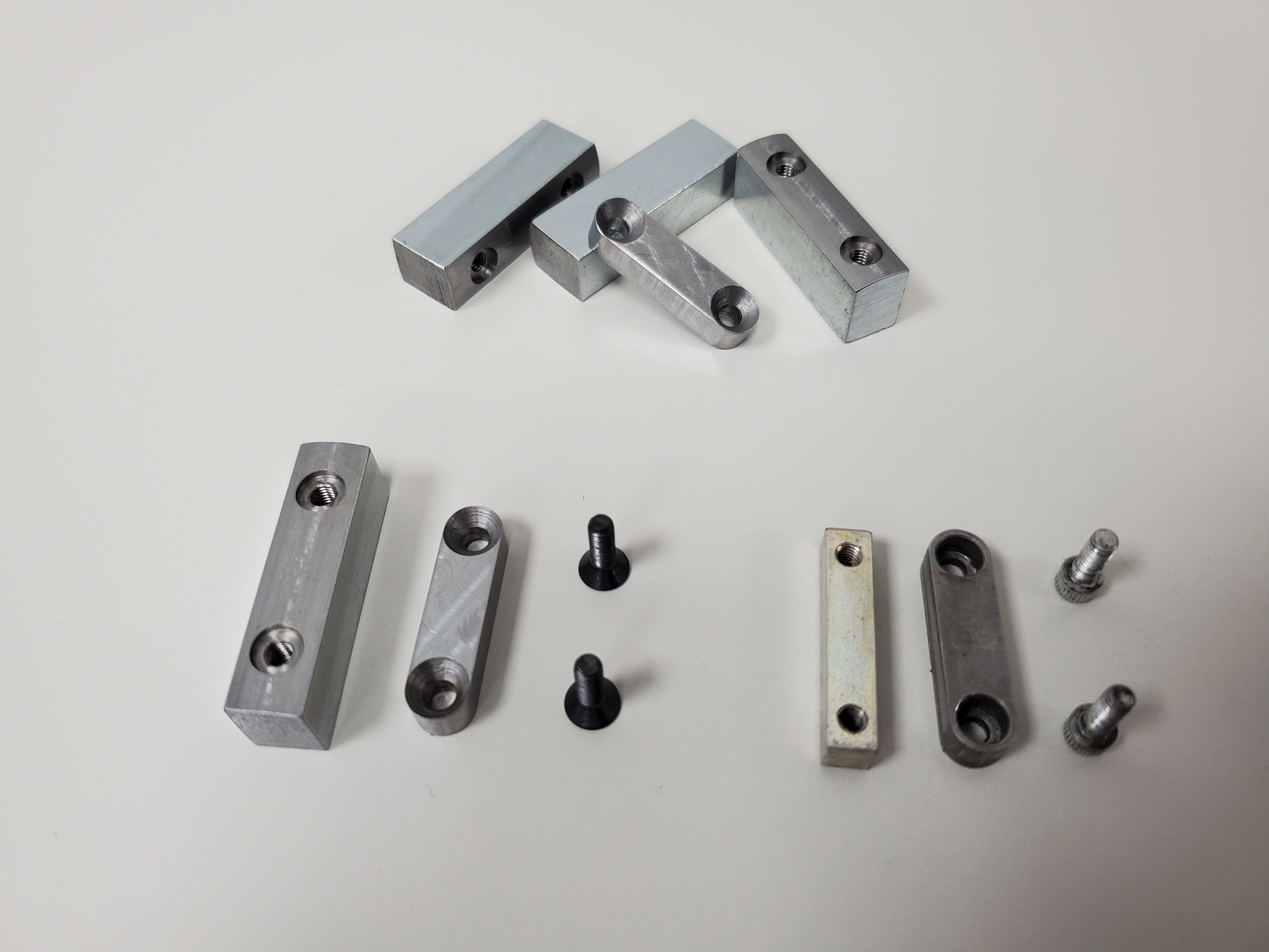

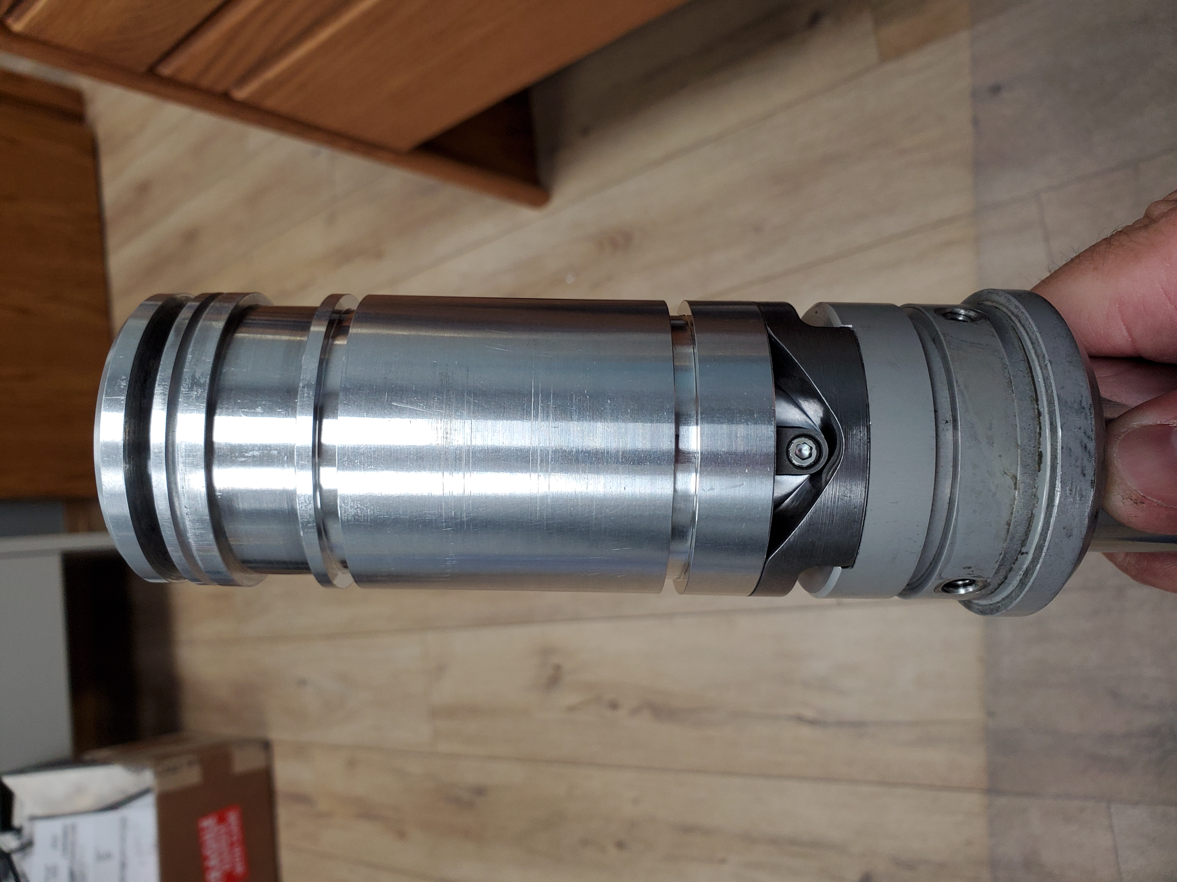

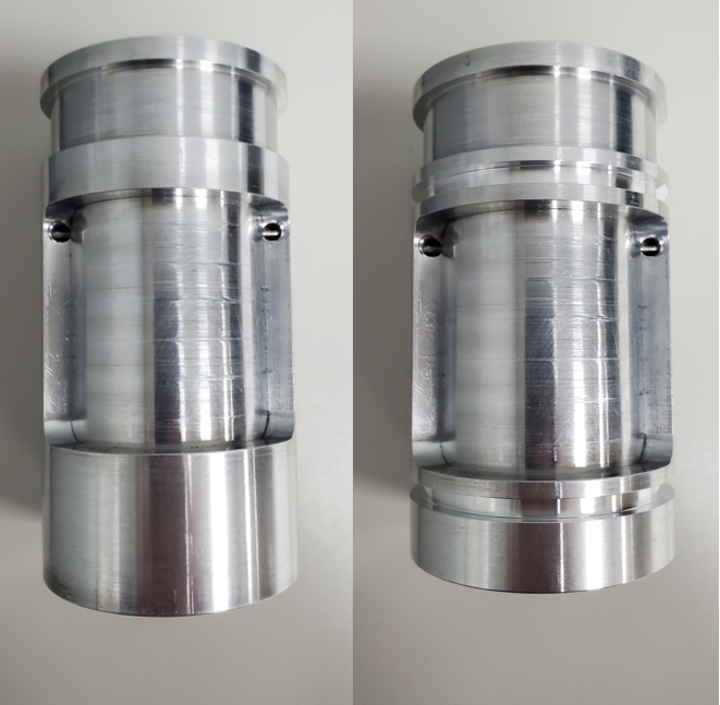

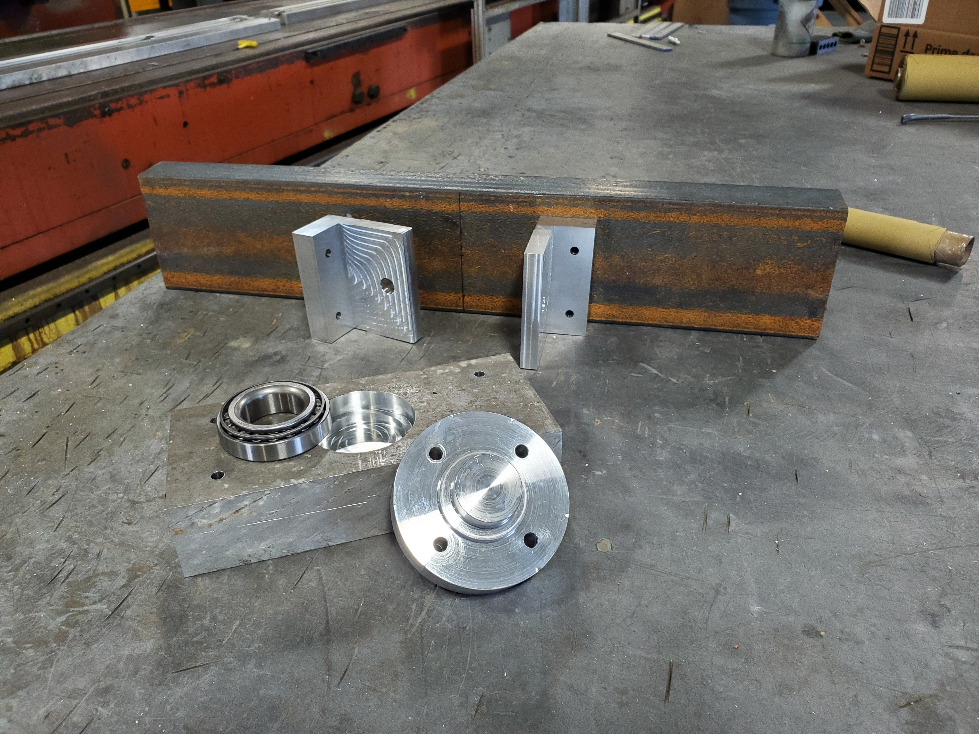

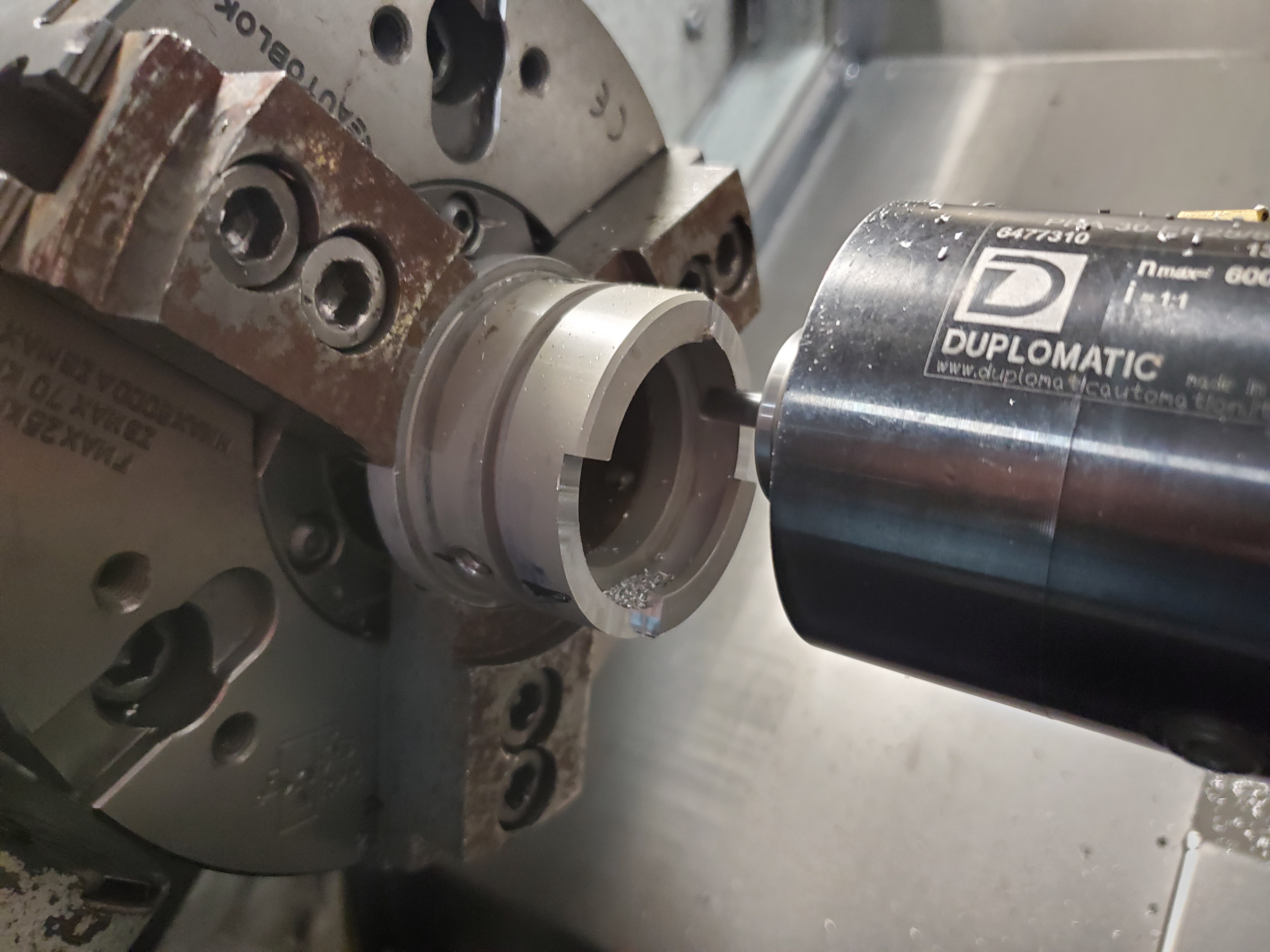

The Esco strut on my 360 was one of the early ones, it was non-self centering and didn't have the latest shimmy damper upgrades found on the later 360 struts. A few years ago I upgraded it to self-centering and changed some things to improve the shimmy performance. There were a few parts I needed to make and some I had to modify.
• New centering cam
• Modified existing bushing housing to interlock with centering cam.
• New Guide Key & retainer set w/o-rings and countersunk screws (my original was only Loctite sealed w/ counterbored holes)
• Modified existing rotation sleeve with the two extra o-ring grooves and shortened
• Modified my rotation key to add a second groove
• Modified original flange with slots
• New flange shim
• New strut collar
Would I do it again? I'm not sure, there are a few things about the design of the Esco I don't like so I think I would prefer to build a new strut. The mod is certainly not something anyone can do, even overhauling these struts requires a number of custom tools, usually owners don't understand this until the strut is half disassembled on the bench.

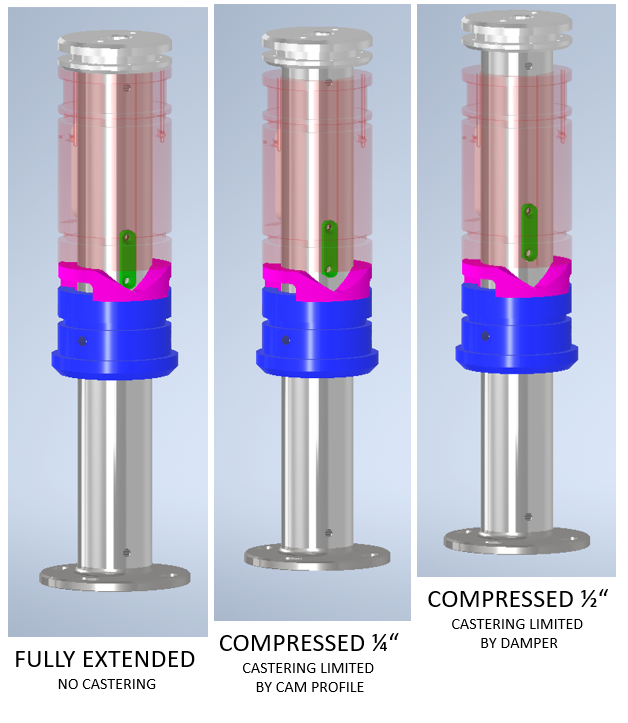

To give a better idea of how the esco strut self-centers near the full extended position:

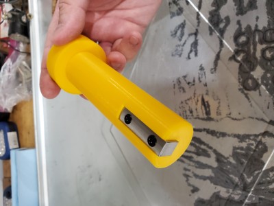

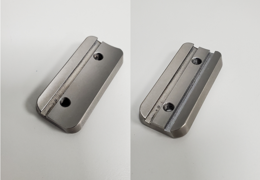

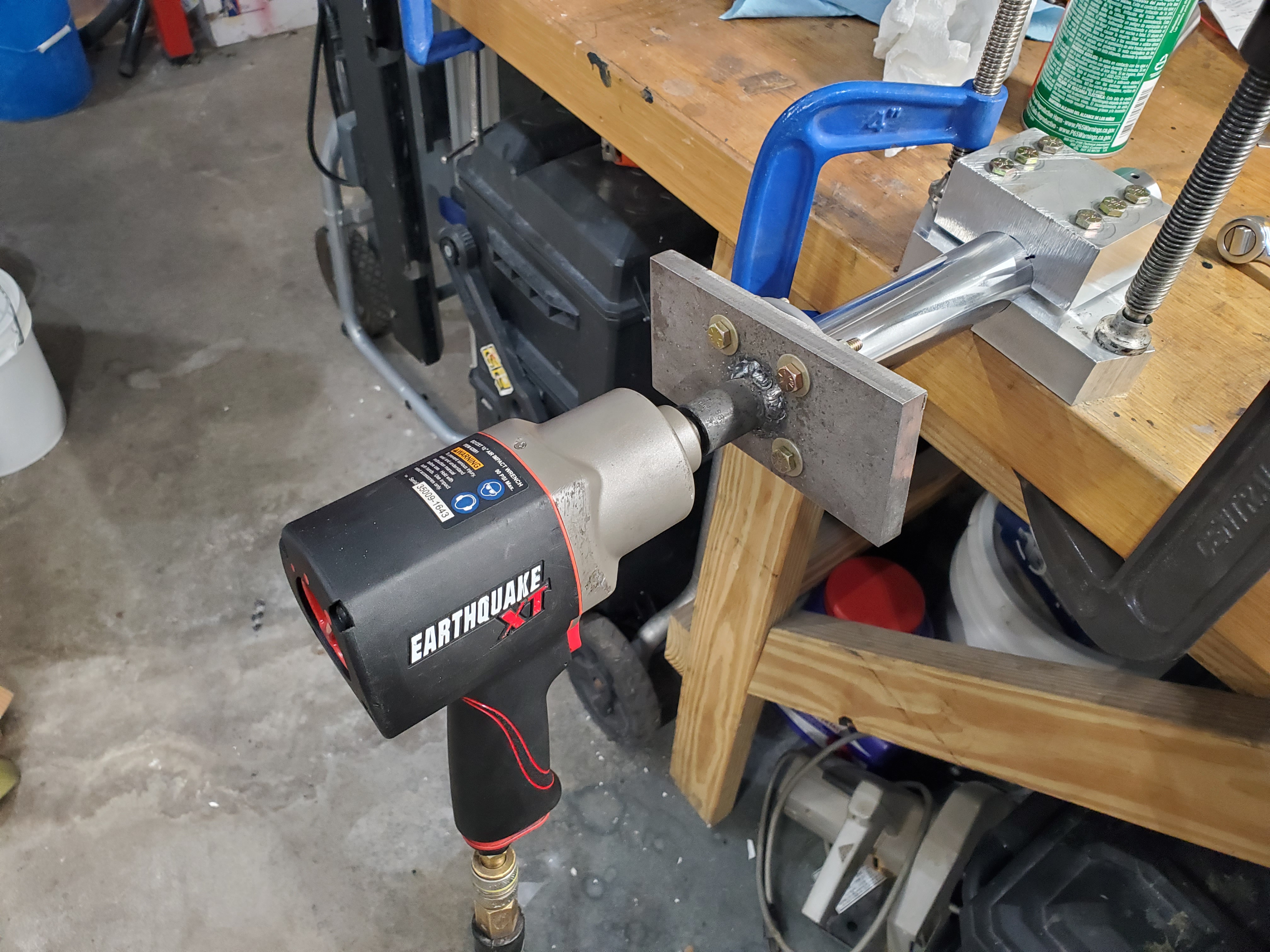

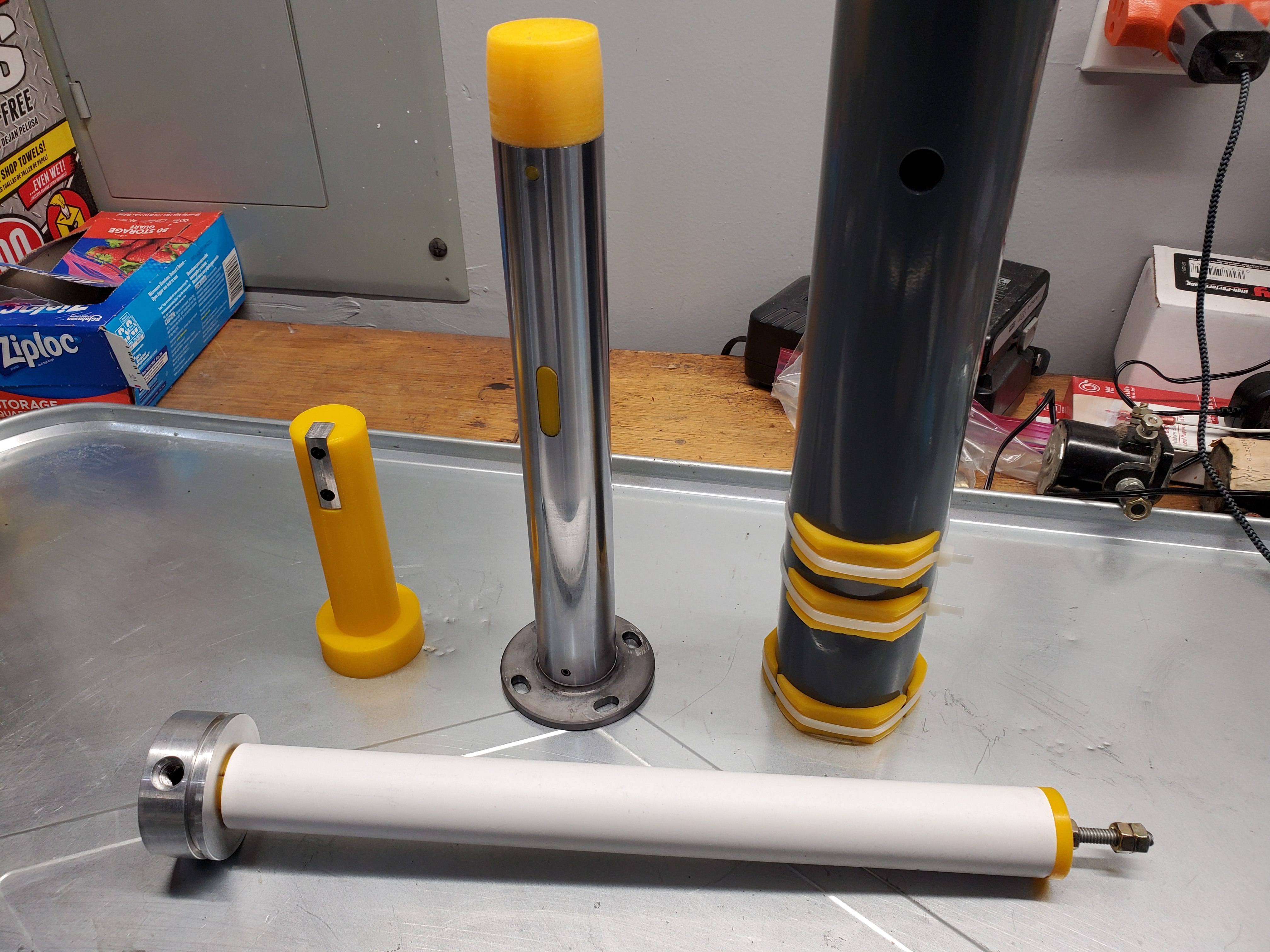

I've had a number of owners ask for me to overhaul or upgrade their nose strut or for me to instruct them what they need to do themselves. The nose struts require a number of tools and fixtures in addition to the seals. These really require machine shop equipment to produce so its not something the average mechanic, builder, or owner should take on. Most owners don't realize this and assume its as simple as changing some o-rings. While I have all these tools doing repairs really isn't my thing so I almost always recommend they talk to Chris Z. Chris is well setup to work on these even stocking new replacement pieces.

This is just a sampling of the tools required to do the basic overhaul on an Esco nose strut:
