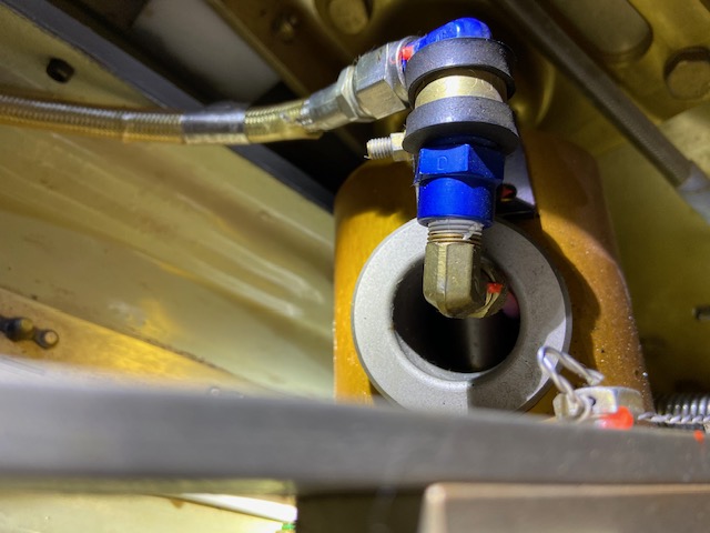

You will want to replace ALL the nylaflow lines, even the ones that connect to the master cylinders. See pictures of my plane before I replaced the lines down the legs with the small stainless tubing. See how you connect to the trunion, etc.

George, how did you connect your stainless steel tubing? I'm struggling to find AN819 sleeves and AN818 nuts for 3/16 OD tubing.

The ends of the stainless steel tubing are connected with compression fittings.
You will need to order from McMaster Carr...
2 - 6' smooth bore seamless 304 stainless steel tubing 3/16" OD 0.028" wall thickness, PN 89895K716 ( these will be cut to length during install)
2 - Yor-Lock straight compression fittings, PN 5182K806 (these connect to the lower end of the new tubing inside each gear leg)
2 - Yor-Lock 90 deg compression fittings, PN 5182K819 (these connect to the upper end of the new tubing inside each gear leg)

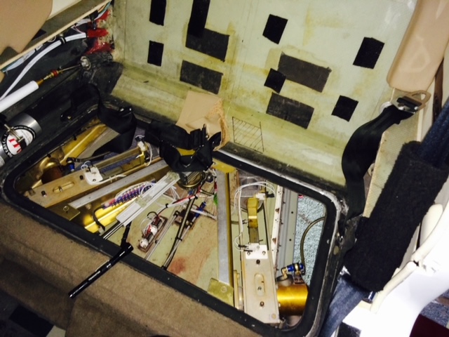

Good news is that I was able to take a better look at this (and pull the rear seat floor). And it appears that this might be a hydraulic leak, which just made it into the axle mount through the outside of the gear leg. Haven't found the source of the leak yet, will try to make some progress this weekend.

Finally had some time to work on the plane. I'm pretty convinced now that this is not a brake problem and a leak in one of the hydraulic circuits made it to the axle mount along the gear leg. I cleaned everything up and I can't make it seep by pressing on the brakes.
I did buy all the parts and we'll replace them at the condition inspection in a couple of months. Thanks everyone and thanks George for instructions!
Now to figure out which fitting leaks...
